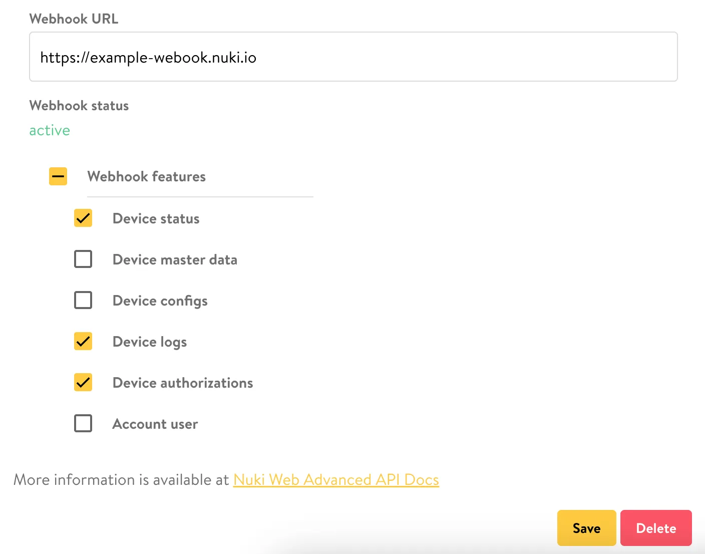

Central Webhooks
Section titled “Central Webhooks”Central webhooks are the default setup for receiving webhooks. This implies that all webhooks will be sent to one single webhook URL.
This webhook URL is defined during the Advanced API application process, but it can be updated within your Nuki Web account.
You can also choose which device triggered webhooks should be sent to this webhook URL via the checkboxes.
