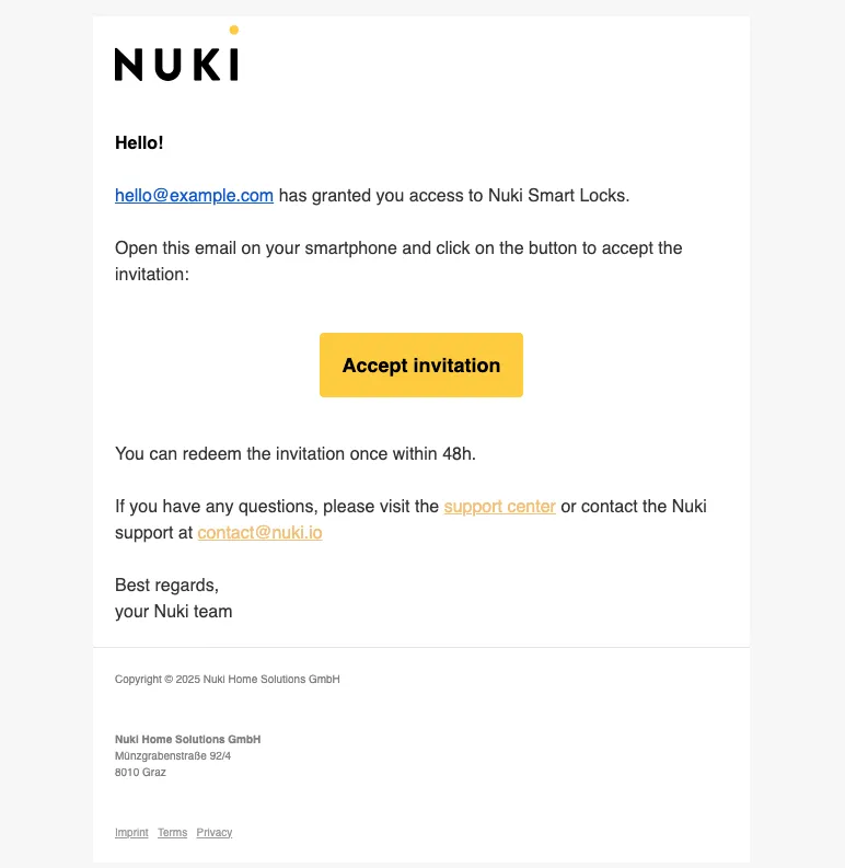

Create an app invite code, but don’t send it to my guest
Section titled “Create an app invite code, but don’t send it to my guest”If you would rather communicate the check-in instructions directly with your customer, you can use the dedicated advanced smartlockAuth endpoint to create an app invite. The request payload is the same as per the previous example.
This endpoint will cause an API-triggered webhook to be sent, with a payload including an inviteCode.
{ "inviteCode": "ABC-DEF-GHI", "detail": [ { "smartlockId": 123456789, "success": true, "id": "68cbe8a..........b5b12201", "authId": 987654321 } ], "type": "AuthCreation", "requestId": "68cbe8a..........5b121ff", "success": true}This invite code can now be forwarded to the guest for them to redeem in their smartphone app.
This invite code is still only valid for 48h, so we recommend creating and forwarding the invite code approximately 24 hours before check-in to the guest.
